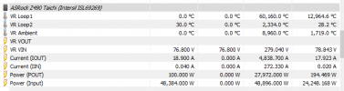

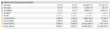

Hey,
I recently noticed that the VRM sensor readings of the ISL69269 on my board are finally showing up, but, as the title says, are of no use.
I attached the debug file and to screenshots to show what's going on.
Thanks in advance

Are you perhaps running some other monitoring tool (i.e. ASRock A-Tuning or Motherboard Utility) along with HWiNFO?
Lukas0610
No, no monitoring tools running besides HWiNFO, I also already tried closing every running program possible (and restarting HWiNFO afterwards), didn't fix the readings.

Lukas0610
Works far better now, the values seem good (although they don't really add up, but I assume it's how the sensor reports it), don't need to reboot anymore, only that it says ISL69138 now and there's a second VRM with only temperatures and input voltage showing.
  • HWiNFO64-working-but-isl69138-recognized.DBG.7z
Well, yes it could be a 269. However proper identification requires a certain function, which doesn't work in this case. I'll look into this a bit more.
