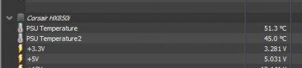

My Corsair Commander Pro just wont show up at all. Corsair Link and Asetek Support is enabled and an Corsair HX850i power supply (attached to Commander Pros USB Port) is working fine.
Commander Pro works fine when iCUE is running but never appears inside hwinfo.
So why is the Commander Pro not recognized as the only device?
Firmware is 0.9.212 (latest) and Hwinfo is 7.10-4540
Thank you!
PSU reading is fine (attached to commander) but no commander pro?

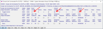

Interesting, I guess the $64,000 question does the XT use the same protocol as the Pro. If yes it should be almost trivial to add support, if not then all bets are off. If the Input + Output +Feature lengths are the same they I suspect it hay use the same protocol.
To find out I would need to add some code to SIV and check what happens, do you know the XT USB VID + PID please, the pro is 1B1C + 0C10 and I expect the VID will still be 1B1C and the PID slightly different.
