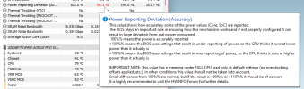

Using the Asus B550-E "Gaming" WIFI with stock settings (only AMP/XMP/DOCP enabled), HWiNFO is reporting values between 89.7% and 256.2% - the latter figure is confusing as it's not (I believe, and apologise if incorrect) covered by the fascinating write-up in the opening post.
The Asus board does feature two telemetry-related settings in the BIOS, but I've not touched them. What does the 256% figure mean?
Please ignore this post - I'll leave it here for reference but I made the mistake of not running an all-core load, which means the figure is going to be incorrect. I would suggest hiding this value by default, or not making it red by default in future versions as it can be confusing.
