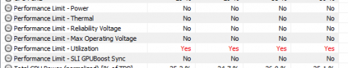

According to HWInfo my GPU temp can be as low as 41°C, but the "Power Limitation - Thermal" reports Yes. How does it know that?
This must imply that there is another thermal sensor on the card, but nowhere else does it show any other GPU temps. I can see the clocks slowing down which also suggests thermal throttling, but I was curious how it's thermal throttling if there's no temperature read out on HWInfo.

The NVIDIA driver is responsible for providing this information, so there are 2 possible explanations of this behavior:
- either this flag is not correct and NVIDIA needs to fix this in the driver, or
- it's correct and (as you assume) some other component is reaching the thermal limit
In the second case it would most likely be the GPU memory, which can reach quite high values, unfortunately no one (except NVIDIA) is currently able to determine the actual GPU memory temperature:
We have spent some effort how to determine this, but haven't been able to figure it out yet. Still keep trying...

I have a ASUS ROG Strix 2080Ti which functions very well, yet one of the values in this series is always 'yes'. Sometimes more than one. The card is overclocked to about 2Ghz using Nvidia's own OC scanner.
I used to worry about it, but I've had yet to see it do anything unexpected, and the temps have never exceeded 84C
This "Utilization" reason mean the GPU is not under sufficient load to drive the clocks higher. So it's not issue at all ;)
