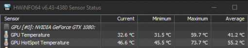

On my GTX 1080 the hotspot temperature just seems to be core temperature + 14°C. The temperature delta between the two sensors is exactly the same regardless of load (tried OCCTs 3d test where GPU peaked at 59.7°C, Hotspot was at 73.7°C. At idle the GPU Core is at 31.5°C while Hotspot is at 45.5°C Same for any other load in-between those two extremes. If its just a static offset that kinda defeats the purpose imo

We have no insight how exactly does NVIDIA evaluate and calculate the temperatures, but many other users reported a variable delta between both values.

1080TI and same +14 here...
