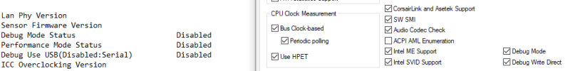

I am kind of confused as to why this debug is acting this way as well when looking at the log file. Text by the way is not supported in the form which is why i couldnt see it when trying to attach it.1685656160310.png

Its been opening up now for whatever reason but its like this never loads. The summary which shows the GPU and CPU is instant so that's why im so confused. 1685906872637.png
