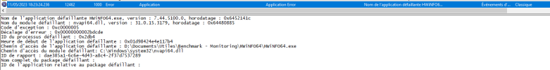

This is what I have at the time of the bug:
HWINFO is correctly linked to nvapi but there is not much more unfortunately.
Maybe it's just that, sometimes, the NVIDIA driver launches AFTER the Fan Control and HWINFO resulting in this bug. Weird is that event rebooting the driver (CTRL+WIN+SHIFT+B) does not restore the bug.
Try disabling the "Fan Control" and look whether you ever have that problem again!
And I myself never use or trust C# stuff anyway... :cool:
The problem is in GPU driver, this is also confirmed above - in calling NVIDIA nvapi64.dll.
You should report this to NVIDIA.
