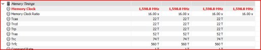

I have some strange readings in HwInfo64 7.16 and would like to clarify whether these values are perhaps being read incorrectly.
I own a Lenovo T14 Gen1 notebook with the above APU.16GB (Samsung) memory are soldered, 16GB (Crusial) are additionally installed as SO-DIMM.
The clock rate of the RAM is always displayed to me as 1598.8 = 1600 MHz = 3200 DDR rate.

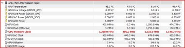

The graphics memory clock is also constantly displayed with 1200 MHz. Only under heavy load does the display reduce to 800 MHz.
Today I also saw 1333 MHz once.
According to HwInfo, the 400 MHz of the graphics memory recorded in the picture is only very rarely present for a fraction of a second. However, the AMD graphics driver says that the 400 MHz should be present quite often.
The GPU driver is responsible for reporting of actual GPU memory clock and this is sometimes not reliable as has been also described in Radeon Software release notes:
Known Issues​
  • Radeon performance metrics and logging features may intermittently report extremely high and incorrect memory clock values.

Then I can assume that the values from HwInfo are absolutely reliable.
Then my system memory is actually always running fixed at 1600 MHz (DDR 3200) and consumes more energy than is actually necessary.
Even if the memory controller display is constantly moving up and down, I can assume that the memory chips are always running at a fixed clock rate.
And my memory controller is not running at the clock rate that should actually be possible with a Renoir APU? Up to 1600 MHz with DDR 3200 memory.
Normally IF, UCLK & MemCLK should run in sync for best performance?
Have I interpreted this correctly?
The highest measured UCLK clock at the highest possible load was 1200 MHz.

Well, the situation with APUs is a bit different. Since the iGPU shares the same system memory, the GPU and main memory clock should be same.
However AMD said in the past that for APUs one should trust the iGPU memory clock as the main memory clock reporting doesn't reflect some low-power states. However, we have no proof for this and AMD never provided further details. Moreover, we've also seen many times that the GPU memory clock wasn't reported correctly. So you might better ask AMD, though I'm not sure if they will provide a clear statement.
