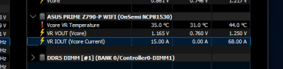

Didn't want to start a new thread for something that might be tied together from Asus. The other day when my system (Asus Prime Z790-P Wifi) came out of sleep my VR Vout (Vcore) voltage showed it was at 5volt and HWinfo 64 Pro v.8.10-5520 wouldn't reset. Did a restart and all was ok the sensor seems to read from (OnSemi NCP81530) I didn't get a Debug because it only happened that one time.

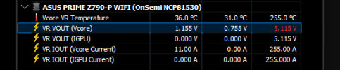

Martin,
Had another one of the spikes but this time I was able to take a better screen shot. It looks like the whole controller flaked out for second, I say this because it's showing a 255c for temps. I don't see this as a issue with HWinfo. I turned off the Alert I had set up for it and when the controller flaked this time it didn't cause HQinfo to lock up.
This is certainly a glitch in the readout. It can also happen when running some other incompatible monitoring/tweaking/RGB control tool along with HWiNFO.
