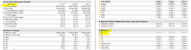

I imagine this is a bug but wanted to get confirmation if possible.
Went from B650 Tomahawk to a X870 Tomahawk, I have a header "NUC126" which shows a "t1" reading, it comes and goes (greys out) but it shows variations between temps, Min: 34c. Max 125c, avg, 105.1c
Not a clue what it is but the cpu, ram, gpu are all in check, even during stress testing ram+gpu loads: First image is the NUC header, below are just other temp values.
Hwinfo version: 8.16-5600
That's certainly an invalid (floating) sensor input. It should be ignored and will be removed in the next build.
Thank you. I was about to report the same for the X870E Carbon motherboard. Also the Core VID value is bugged and showing crazy high values. The NUC126 T1 and T2 sensors also randomly disappear, turn grey, then reappear. I believe the Core VID is accurate if I use PBO. But, I do not use PBO. I use fixed clocks and static voltage. I'm wondering if that is an MSI BIOS bug.
