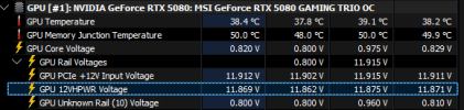

Is it common to have these voltage readings bellow 12v?
I've read (and maybe miss-interperated) that its best to have these readings as close too 12v as possble. Since getting my 5080 i have never seen these readings get to 12v. They are always around 11.9-11.8v.
Apparently this is a sign of a cable that could melt?
Thank you in advance
Yes, it's normal, especially under load. 11.8-11.9 V is still within the acceptable range. Below ~11.6 V it would be a problem.
Thank you Martin :)
I was doing some comparsions between my own set up and my freinds, we both have the same PSU and GPU so was assmuming seeing as he was as 12v i should be too, but each set up even if components are the same are going to have differences i suppose
