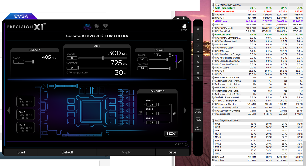

I have version 6.03 and I have the 2080 Ti FTW3 iCX sensors but it is only detecting two of the three fans...
Edit: Also GPU Fan0 and GPU Fan1 appear to be duplicates of Fan0.
3686 is even weirder.. Ideally we should have the three individual fan speeds in the iCX sensors section...

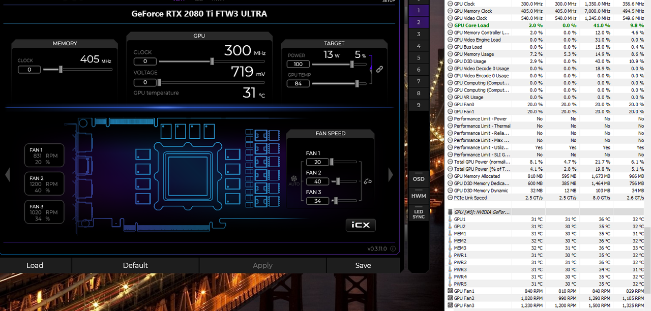

Restoring the order didn't change anything. I think it is giving three individual fan readings but two are named Fan1... I will try setting a random rpm on each fan and observe the readings. I will get a debug asap.
When creating the DBG file, please also note the actual fan speeds. It would be great if each of them would be running at a different speed, so I can match them.
I believe that both Fan0 and Fan1 (duplicates) under the NVIDIA heading represent Fan1 shown by EVGA.
Ok as I manually adjusted the fans all three appeared in the iCX section so it appears to be working...
