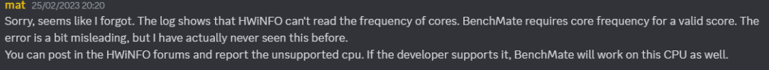

I was talking with a BenchMate dev the other day, and he told me, after looking at the logs i provided, told me that my issue was that HWiNFO was not able to read the clock speed of my CPU.
Here's the end of the logs that benchmate provided me about the issue:

So Mat, the benchmate developper, told me to reach to you if i wanted to fix this issue :)

Okay. If i understand correctly it is an issue of HWiNFO not communicating to BenchMate the cpu clock, because the hwinfo software is reporting it correctly, cpuz too. I have the Debug Log coming from BenchMate but no issue with hwinfo itself, so no bug report i think, but here is one anyway. I already asked again the dev to know if it is really a hwinfo issue...

Yes, HWiNFO reads the clocks well, so the problem is most likely in how BenchMate retrieves them from HWiNFO.
