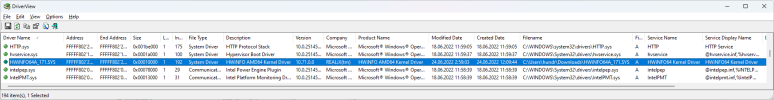

This is interesting. I have extracted the HWiNFO64A_171.sys by running HWiNFO64 on another system. Then I have written my own software to load the driver into Windows 11 build 25145, the software simply loads the driver and starts the service, nothing else:
A service was installed in the system.
Service Name: HWiNFO64 Kernel Driver
Service File Name: C:\Users\hundr\Downloads\HWiNFO64A_171.SYS
Service Type: kernel mode driver
Service Start Type: demand start
Service Account:
Now that driver is loaded, I can start HWiNFO64 again, with all HVCI protection enabled. :D I guess HWiNFO checks if driver is already loaded before it actually tries to load one itself.
I don't know if that matter or not, but I named this service 'HWiNFO64 Kernel Driver'.
