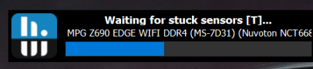

Latest versions of HWI seems to have a conflict with cc_engine_x64.exe and results in hung sensors. If I setup to start in debug mode, HWI never launches. Need to keep MSI Center as it controls my AIO pump/fans. HWI 8.26 does not have this issue. Attaching DBG from latest beta version 5775, and report from 8.26.
Stuck sensor I believe is the Nuvoton NCT6687D. Once it gets stuck (almost instantly, the temperature readings for Current readings show 0C).
Can't figure out what changed between versions, but 8.26 and older runs perfectly.

Can't confirm if values are always correct with older versions, notice they do keep updating with a non-zero value though. And fan speeds on my AIO cooler don't go crazy with HWI running. Once the ISA lock warning pops up on newer versions, the AIO fans will spin to max speed so it seems the other app doesn't like something HWI is doing with the sensors and gets locked out from being able to determine CPU temps so it just maxes out the AIO.
Do you seen an "ACPI" sensor in the list? If yes, try to disable its monitoring by pressing the Del key over its heading.
Disabled the ACPI sensor below, once disabled all the errors go away! Thanks for the help - not sure if there's something on the HWI side you can fix, but this works for me.
