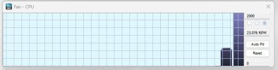

Hi, I found another anomaly. For the CPU fan when you return to 0 rpm you get incorrect values like 24,000 rmp. I temporarily solved it by excluding values greater than 3000.

When this happens, does the fan really switch off and stay at 0 RPM? So the >20,000 RPM is displayed while the fan is stopped?

The cpu (liquid cooling) fans at idle are stopped and read correctly at 0 rpm. After launching any CPU test, the fans activate and adjust based on the temperature. once the test is finished they physically stop (0 rpm) but the program reads very high values. I don't have any other programs that read these values.
OK, can you please note down what exact invalid values does it report in that case? The minimum and maximum invalid range.
