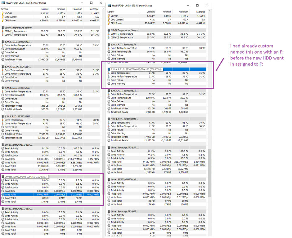

Kol12
Note the end numbers Z504SN0J and Z505SN0J. Are they the same drive?
Kol12
Just unsure about the S.M.A.R.T info for ST3000M008. The read/writes are correct at 88MB/174MB as this is a brand new drive.
OK, I see now. If you have renamed the labels then the entire custom label you used (including the serial number) is kept for a device at the same address.
Try to rename the label again, it will then show the original (new) serial number.
