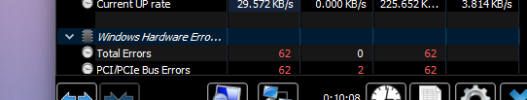

I have been trying to fix the wifi in my G14 2022 because it keeps cycling/dropping recently. I switched my intel card back out for my mediatek card and same problem. It just vanishes or stops working randomly which usually has to be hard reset to come back.
I have found out it may be my M2 sitting on top of the wifi card in the laptop overheating it, so I downloaded hwinfo to monitor the temp of the wifi card (which I can't find), and I see that 61 total errors were reported in less than 5 minutes.
Obviously this is a problem. Can someone teach me how to generate a report and find out what's happening and how I can fix this?

Yes, these errors are indeed generated by PCIe Device in Bus #5, which is the "MediaTek MT7922 Wi-Fi 6E 160MHz Wireless LAN Card"

If two different cards from different vendors show the same errors, then I think it's something with the slot, mainboard (routing/signals) or BIOS.
I'd recommend to consult the notebook vendor and maybe file an RMA.

Okay, so I went and removed the gel thing on the bottom of my nvme so that I only have the copper heatsink and gel on top to give it more space inside the laptop (before I think it may have even been touching the wifi card which probably caused interference and to heat and fail).
It seems to be working fine with no errors now. I will update further if things change!
