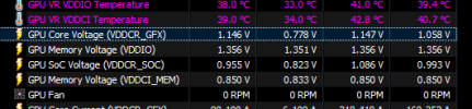

Im seeing amd radeon software report 1150 to 1175v while hwinfo reports a max of 1.136v and that while i have set prefer amd adl on.
Im currently testing broken drivers from AMD MPO being broken and possibly power states possibly as well, but that is probably unrelated to the issue with hwinfo.
Which value in HWiNFO are you referring to, the "GPU Core Voltage (VDDCR_GFX)" ?
AFAIK AMD drivers/ADL often report the voltage request, not the actual measured voltage. So HWiNFO should be more accurate.

The FPS reported by HWiNFO relies on an internal GPU counter, which doesn't seem to be very reliable.
You'll have to stick with the RTSS one if you want a more accurate.
Meh i guess its just AMD bug with fps counter perhaps i should bug report it to them instead, im guessing the gpu voltage miss report is easy fix tho since it does report correctly in radeon software
Radeon software most probably (and ADL) report the voltage setpoint (requested voltage), while HWiNFO reports the voltage supplied/measured. So it's similar to difference between VID - Vcore.
IMO "correct voltage" is what HWiNFO reports.
I do like to update that 22.11.1 now reports voltage higher again i gues the real value is proof why it was unstable before and causing system freezes.
AMD drivers are freaking nightmare i guess seeing real value of the voltages are more useful then what AMD ADL reports.
