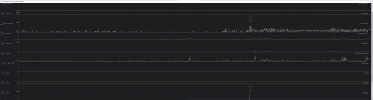

Yesterday I had in happen it less than hour. Yesterday evening I rebooted my pc for installing something, and some minutes later I played ACC and after quit I noticed that thermal has been triggered in hwinfo and then I just opened the AB monitor and extended the window maximal width. My monitor is large and it fits about one hour of data :)
Here is sample screenshot from today taken few minutes ago :)

The difference in capturing of the thermal limit is most likely because it's a very short spike and it depends on the polling interval in a particular tool.
The fact that MSI AB sees this too confirms that it's correctly reported. Why it happens - only NVIDIA knows exactly as this is what the drivers say. Might be a bug there...
