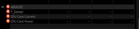

Thats very odd, my Asus X570-E can do something similar with post code display but it has not been an issue yet, mine is showing thermal probe from watercooling fitting however hwinfo advices always to turn of checking those sensors and turning it off, does it do this on your boards for those with problems ?
This is how i got it disabled
And i have no issues, if no need to monitor it anyway i can see it right on my post code display anyway
