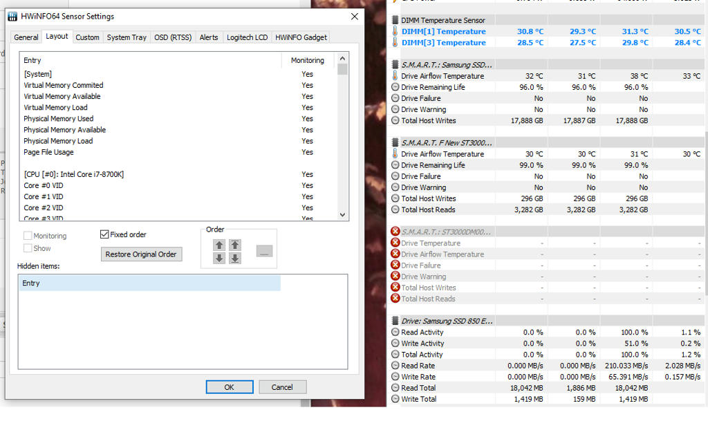

Kol12
Here we go. What exactly does resetting the preferences in the main settings do? Will I lose of my custom layout customization's?
Ah, that means monitoring of that sensor is disabled. Just hit the Ins key over that sensor heading or right-click and choose Enable Monitoring.
Kol12
Do you mean the ST3000DM08 with red x's? That's not actually the problem drive it's my Samsung 860 EVO...
Ah sorry.. And do you see that drive with SMART data in the main window ? That's the window with tree on left side, note that if you're using sensor-only mode, you will need to deactivate it in order to get that window shown.
