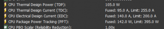

Another question i've set up my limits on Motherboard for PBO
What meants "fused" right here?
Thanks again

If you choose to set PBO on just “Enabled” the limits are even higher than that. Basically by enabling PBO without any manual settings you are telling the CPU to operate at its max potential without damaging it self.
Its safe.
All is depending on the CPU temp. The cooler it is the higher is pushing its limits. Again without damaging it self (when PBO is set to Enabled or advanced/Motherboard).
Of course those numbers are unrealistic and there is no way a (any) CPU can reach them.
