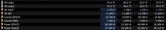

VR VOUT is high on DDR3 system (1.775v)
RK79
From what I understand, the description states that this sensor can be either VCORE, VDIMM, VCCSA etc, but I have not set the voltage for anything to 1.775v. For reference, the highest voltage that I have set for anything is my DRAM voltage which is 1.65, why is this sensor reporting such a high voltage?
This sensor can also be something else, i.e. FIVR +1.8V, it depends on the mainboard.
