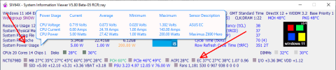

After posting I checked if SIV had code to report EC sensors on your ASUS ProArt Z790 and it didn't so I added it for SIV 5.80 Beta-04. It would be wise to check what SIV reports when the system is working as expected, there should be System Power Usage + an EC section on the initial screen. I wonder if it will still detect/report them when there is the issue and suspect you will have to abort HWiNFO so SIV can get the Global\Access_EC lock.
I downloaded that beta using your link, thanks. I will get some baseline info as you suggest.
