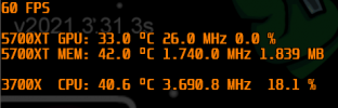

I think it would be best to show you with examples:
Original when idle (misaligned):
Original when GPU frequency at max (aligned):

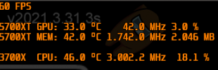

Align digits (5) when idle (aligned):

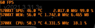

Align digits (5) when GPU frequency at max (misaligned again):
Anchor point for Align digits option should be set differently.

I see. This is probably because you're using the same thousands and decimal separator and that's confusing (not just) HWiNFO.
Try for example to use a comma "," as the thousands separator.
VidKo
Not probably, it indeed is so! Thank you so much!
I kept banging my head and searching for a solution the whole evening yesterday and it was me who caused the issue in the first place :D
