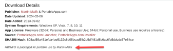

EDIT: I think I found the issue, I use this https://portableapps.com/apps/utilities/hwinfo-portable and just copy in the latest beta versions as they come out into the folder containing the 32 and 64 bit versions of hwinfo. I've been doing that for years and it's always worked without issue until HWiNFO v7.73-5375 Beta came along. Something changed in Hwinfo that is causing the hwinfoportable.exe launcher to not run it. It hadn't even occurred to me to test hwinfo on it's own cause, as I said, for YEARS the portableapps hwinfo launcher worked flawlessly

I don't use YOUR launcher, I use the launcher created by Portableapps.com
Well, that is where the problem lies as this is what happened. The problem started with v7.73-5370 if you read the thread: https://www.hwinfo.com/forum/threads/hwinfo-v7-73-5370-beta-released.9513/
because of the OSD which requires HWiNFO64.exe to start from anywhere under "C:\Program Files" as mentioned here:
"For the overlay to work properly, HWiNFO64 is requesting uiAccess=true so that the overlay can be shown on top of other windows including full-screen applications. This special mode is only granted to applications started from a "secure folder", which is the "Program Files" (by default C:\Program Files) folder and its sub-folders, or some folders in the \Windows path. The HWiNFO installer will automatically install HWiNFO into the "Program Files" folder, so no action should be needed. When using the Portable or Beta version of HWiNFO, it's required to manually copy HWiNFO64.EXE into such "secure" folder."
While it did not mention that HWiNFO64.EXE cannot run as a task when outside of the "C:\Program Files" area, HWiNFO64.EXE will not run as a task when outside that area because it is a uiAccess app due to the OSD function as mentioned in https://www.hwinfo.com/forum/threads/hwinfo-v7-73-5370-beta-released.9513/post-44193 which is a Microsoft Requirement:
v7.73-5375 fixed this issue because in v7.73-5375, when one turrns on autostart in settings, it creates a task as well as the file HWiNFO64Launcher.exe in the same folder which is what is now run that calls HWiNFO64.exe. You do not need another launcher as HWiNFO is already portable by default since all you do is run HWiNFO64.exe manually and it will start after showing the UAC screen with all settings in the HWiNFO64.INI file.
So assuming you already have KB4474419 already installed as mentioned by Martin, there are two ways to fix this.
1) Copy the current folder to somewhere under C:\Program Files which means it can be C:\Program Files\xyz or C:\Program Files\abc\xyz\123\456 for example basically it can be in any folder under C:\Program Files and it should work correctly because all hwinfoportable.exe does is run HWiNFO64.exe, if it is elsewhere meaning somewhere outside of
C\Program Files, it will no longer work after v.7.73-5365 as hwinfoportable.exe needs to launch the file HWiNFO64Launcher.exe and not HWiNFO64.exe.
*OR*
2) Do not use hwinfoportable.exe but instead run HWiNFO4.exe manually which should run, goto settings and then check the Autostart box which will create the file HWiNFO64Launcher.exe and a task scheduler task that launches HWiNFO64Launcher.exe
In my case, I wanted to try the OSD as I am on Windows 11 Pro Beta so I have it under C:\Program Files\HWiNFO\hwi_773_5385 but apparently HWiNFO64Launcher.exe is still created and HWiNFO64Launcher.exe is what is run first which calls HWiNFO64.exe so Martin can correct me if I am wrong, can HWiNFO64.exe be started directly as a task from C:\Program Files\HWiNFO\hwi_773_5385 without needing HWiNFO64Launcher.exe as it seems like Autostart creates HWiNFO64Launcher.exe so it will work in all scenarios including HWiNFO64.exe under C:\Program Files even when it isn't needed.

No, the problem is something else. The new HWiNFO64 can be started from any folder but for the OSD to work properly it requires to be located in a "secure" folder. But otherwise it will work.
The problem @Thinkpad sees is different. Applications with uiAccess cannot be started using certain functions like CreateProcess which is also used by Task Scheduler. That's why the HWiNFOLauncher had to be created as it spawns HWiNFO using a different function. The same problem affects the PA.Launcher. I have reached out to PA if they have some solution for their launcher.

Yes, I see what you mean but @Thinkpad never mentioned what happens when running HWiNF064.exe manually if it will start or not. If it doesn't, then there are other issues with HWiNFO64 itself since the HWiNFOLauncher method is only needed to automatically start HWiNFO64.exe after OSD was added to HWiNFO64. PA on their page says HWINFO is packaged and made portable by you so hopefully they will provide a solution when the next released version of HWiNFO is out as they are only supporting 7.72.5355.
