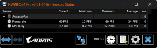

OK, I did some more analysis (watched Gamers Nexus Video) and had a more detail look at the data:
  • a lot of categories are N/A (not available, because of BETA?)
  • in another video I saw, you can use HWiNFO to get sensor information for PresentMon (?)
  • the most important categories are (Gamers Nexus Video)
    - Frametime = log category "msBetweenPresents"
    - GPU Busy = log category "msGPUActive"
In the video they said, best is to have Frametime and GPU Busy "close together" (no waiting). So I generated an addtional (calculated) log category:
  • Frametime - GPU Busy
  • the difference value of these two categories "should be something > 0"
  • ... and we can generic a statistic of this difference
Here are the diagrams:
@NCSGeek: your average values are
  • Frametime: 6.959 ms
  • GPU Busy: 2.693 ms
  • Frametime - GPU Busy: 4.265
  • this shows also the statistics: 90.6 % of your values are around 3.937 ms, 8.3% around 6.132 ms
  • BUT: 0.21% of your frames have a negative value of -0.452 ms -> GPU Busy > Frametime (not good)
I'm wondering why PresentMon doesn't have such a "difference value" ...
Question: Are you planning on updating GenericLogViewer with this?
As I already said: "if Intel sends me a Core i9-13900K + 500 bucks for a motherboard (or someone else will sponsor me), I will do it :cool:

Oh okay I didn't realize that part was in answer to my question about adding it. If he adds this metric to H@Info64 then would your tool retroactively support it?
As for my log I sent and it's values, I wouldn't look too hard into it. it was a brief capture while playing Vampire Survivors (which is a very very lightweight game) so the data may not be very valuable.
Here are some personal thoughts on PresentMon from Intel: I don't think the new metric called "GPU Busy" is a game changer. Why:
  • it logs an extremely large amount of data, example file contains
    - 73 different log categories with each
    - 144 data records per second (so really each frame = FPS)
  • there is so much data being processed, that this processing itself probably has an impact on the performance and possibly generates a bottleneck itself
  • especially if this data is displayed in a live overlay over the game
The tool is supposed to show whether the CPU and GPU have the same performance class and fit together perfectly. In my opinion, however, this is not the typical use case. You start with a PC build, then a few years later you usually upgrade with a better graphics card, because since a few years CPU power has always been cheaper than GPU power. The fact that individual components can be upgraded is the great advantage of a PC and the reason why perfect performance matches between CPU and GPU are the exception.
Best regards
Tom
