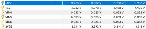

Thank you for your work and this software. However, for me, it shows up wrong values. I've done a couple of logging examples as well as re-downloaded the software. Just take a look at 3 of them; +12V, +5V, and +3,3V. The power supply or whole PC would burn/explode if these values were correct. Or it may be HWiNFO not properly logging them? This software isn't perfect and isn't glitch-free, and maybe this is the problem, not the log viewer itself.

What values are shown in HWiNFO sensors screen are the ones you log correctly shown there?
Take a look at the attached picture for comparison. Values haven't been reset.
Looks OK, so the problem is most likely in the log.. Perhaps the "Logging Separator (CSV):" setting?

I don't have that logfile anymore but I've just logged another one and the problem is still present. No, the logfile is untouched.
"I've reset all HWiNFO sensors a couple of days ago and just started to reorganize them yesterday" In addition to that, I've changed the names and colors of some, disabled a couple of sensors, and hid them.

Nope, I haven't renamed any of them. I've just created a new log file and the problem appears to be across all or most sensors, not only the 12 and 5V lines. I've watched couple of them in HWiNFO while logging and then checked logs right after logging has been stopped. I don't understand :oops: Maybe some HWiNFO setting is causing it? May you take a look on them? I can tell you that I haven't reset sensors to default by HWiNFO panel but closed the software and removed the Sensors inside of HKEY_CURRENT_USER\Software\HWiNFO64\ registry key manually and then re-opened HWiNFO.

It looks like the order of some sensors is shifted by 1 in the logfile and some of them seem not to be using the original name. So I'm not sure whether your registry action worked out.
I'd suggest to do a Reset Preferences from HWiNFO right after starting it and before opening the sensors window.
