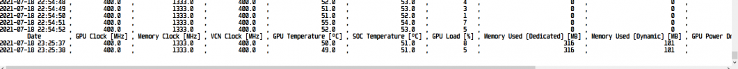

may or may not be relevant but towards the end of you r raw log file yo uhave an extra header row
If I delete that row there's still a gap between 6 mi9nutes into the run and approx 38 minutes
looking at the raw data that Gap starts at 2021-07-18 22:19:33 where the temp jumps from mid 50's to plus 70 then kicks back in at 2021-07-18 22:50:31 when the 79.3c is record
hmm deffo one for @TomWoB
chevron
Yes, I believe that was added when I launched GPU-Z a second time and it appended to the log file again with the new header. I think that part can be safely deleted. I can verify that I also see the same gap you see after I delete that header.
