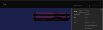

Unfortunately. Still the same. As you can see in CPU-Z it reads data normally. Your program sees some of the data in the sensors, and not in the main window at all.
Fury CTRL normal show temp.
