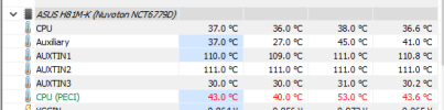

I've added sensor to system tray and set up that thing so it will change color when cpu is higher than 20 C for example. In sensors window it does change color but I thought it will also affect system tray icon. Can I enable it somewhere or is it not supported?
You need to define a separate Alert for the same sensor and when the alter is triggered, the tray icon will also change color.
