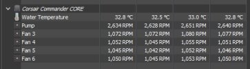

5033 is showing all correct sensors now but LED's on the fans are off again.

Hello all. First off, my PC specs: R9 7900X, 4070 Ti, Hx1000i, H150i Elite Capellix XT w/Commander Core, 6 Corsair AF RGB Elite Fans.
This morning I got an notification to update HWInfo to V7.42-5030. After installing, the LEDs on my fans and pump went to "Hardware" mode and flashed once a second. In HWInfo, the pump temp is greyed out, but fan speeds are updating. On 5031, the LEDs are working again, but HWInfo flashes the temp monitor and fan speeds aren't updating. On 5032, only the pump temp is showing, but it is still greying out every second or two. On 5033, I am able to read the pump temp and all 6 fan speeds, but all sensors are greying out randomly at the same time; my RGB is still working properly on this version.

Thanks for your feedback. Is iCUE running too? If yes, then the grayed-out items are due to collisions with iCUE.
With 5033, the Commander Core sensors will periodically grey out when messing with iCUE, but they are updating, and my iCUE profiles appear to be working without issue.
One problem I just noticed is "Fan #6" in iCUE is not showing up in HWInfo. I believe "Fan 1" in HWInfo is the pump speed based on messing with fan speeds in iCUE, and then the fans not matching up properly in HWInfo.

That did fix my fan/pump labels. With iCUE running and starting 5034, all sensors showed up, only greying out due to iCUE. After closing HWInfo and iCUE, then starting only HWInfo, the Commander Core showed up but without any sensors. I have attached two DBG files with/without iCUE running the background.
