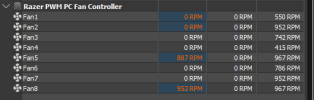

Recently acquired Razer PWM controller and noticed HWinfo is reporting it in Sensors, but values are bogus as you can see from screenshot.
Thought I should report this, even though it does not affect me much.
In case you need logs or any additional info let me know.

Yes, please attach the HWiNFO Debug File for analysis.
Also please tell me which fan you have connected/active.
Apologies I missed the instructions. Was just generating debug and report files.
Channel 5 and 8 are active, each has 3 chainlinked Lian Li SLV2 140mm fans, so 3 fans per channel.

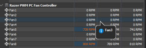

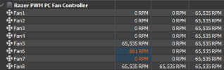

I use FanControl to control my fans, but readings in HWInfo are bogus with or without FC running. I dont use any plugins regarding HWInfo in FC.
The issue seems to be gone with this version, however with FC running it will report values on unused channels.
Otherwise without FC it reports proper channels readings, so I guess this has nothing to do with HWinfo.
Attaching DBG and report anyways in case its needed.

That's a collision with FanControl, that tool probably doesn't support synchronization mechanisms to work with other tools.
