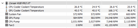

Corsair has recently released a new liquid cooling set, it is based on OEM COOLIT, the set is detected incorrectly as H110IGT, in addition it shows two water sensors of which one of them does not exist, from the fans there are also 3 pieces and one of them also does not exist, The read values are often wrong, the minimum fall to zero, the maximum can jump up to 65535 I would like to add support for this cooling model.
Regards
  • HWiNFO64.7z
Problem here is that the device returns values for 2 temperatures and 3 fans and I don't know how to determine which of them is valid...
Regarding the sensor name - have you maybe renamed it? It should be showing something else...
Dsc
I sent additional screenshots to determine the right spearbooks. Looking at the screen with Hwinfo, the correct indication of the liquid temperature is the sensor called "CPU cooler coolant temperature", the second liquid sensor actually indicates 45 degrees regardless of the state, unless the reading comes to bug, when all values go crazy as in the attached picture.
The fans are real readings "System Fan" and "GPU PUMP", Specjnik Fan3 will appear and disappears from time to time without indicating any reading, apart from the bugs.

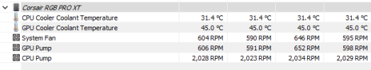

Dsc
Turning off Icue does not change anything about the sensors themselves and their names, now there is no fan3 in the picture, but as I said it appears randomly and disappears.
The only difference is the lack of raging values and to be honest I know that Icue causes, the point is that the same problem was once with my older H115i Pro cooling based on the aset pump, but with one version of Hwinfo the problem disappeared and the values stopped going crazy instead of the cooling value he made gray for a few seconds and the monitoring returned, which was guessed by a circumventing that ensuring a lack of collision with the unfortunate Icue.
It would be nice if it was possible to provide a similar bypass from ICUE for this cooling model, and also provide it with improved support thanks to which dead drunks will disappear, and the rest will get the right name.

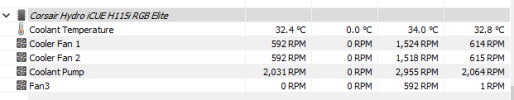

I tested the latest build, definitely feeling the improvement of the highest values definitely reflect the actual state, only the lowest falls to 0, and this unwashing 3 fan still appears, it is a 280mm model with two 140mm fans, but there is also the H150i RGB Elite model equipped with 360mm radiator And 3 120mm fans, I guess that the control board is identical, and Corsair forgot to turn off this 3rd output. Thank you
If the problem is collision between iCUE and HWiNFO then it will never be possible to fully workaround this.
Dsc
I am aware of this, but this third fan probably can be turned off, does it appear completely after Hwinfo control?
